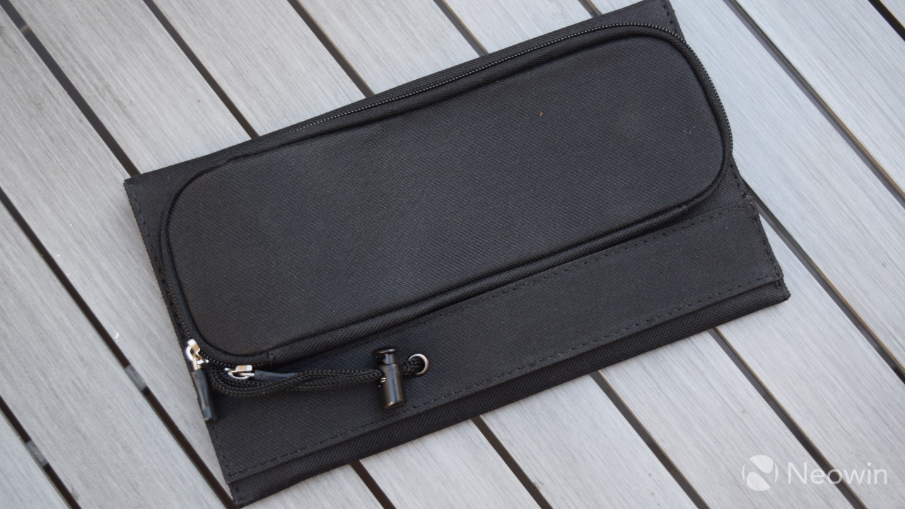

The Dodocool 10,000mAh Portable Solar Charger, when opened, measures 40cm x 15.3cm and is only a few millimeters thick at its thickest point. It is foldable, however, and folds into a 26.2cm x 15.3cm x 3.4cm at its thickest point... although that thickest point is a pouch for holding your things. The pouch is sealed by a zipper and contains the unit where you turn it on and plug in your USB ports. It's big enough to store cables or a smartphone in there, but not much more than that.

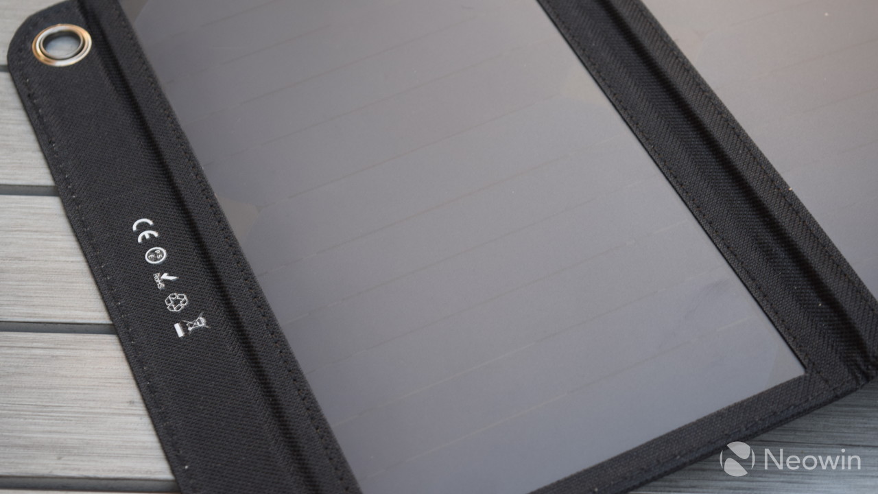

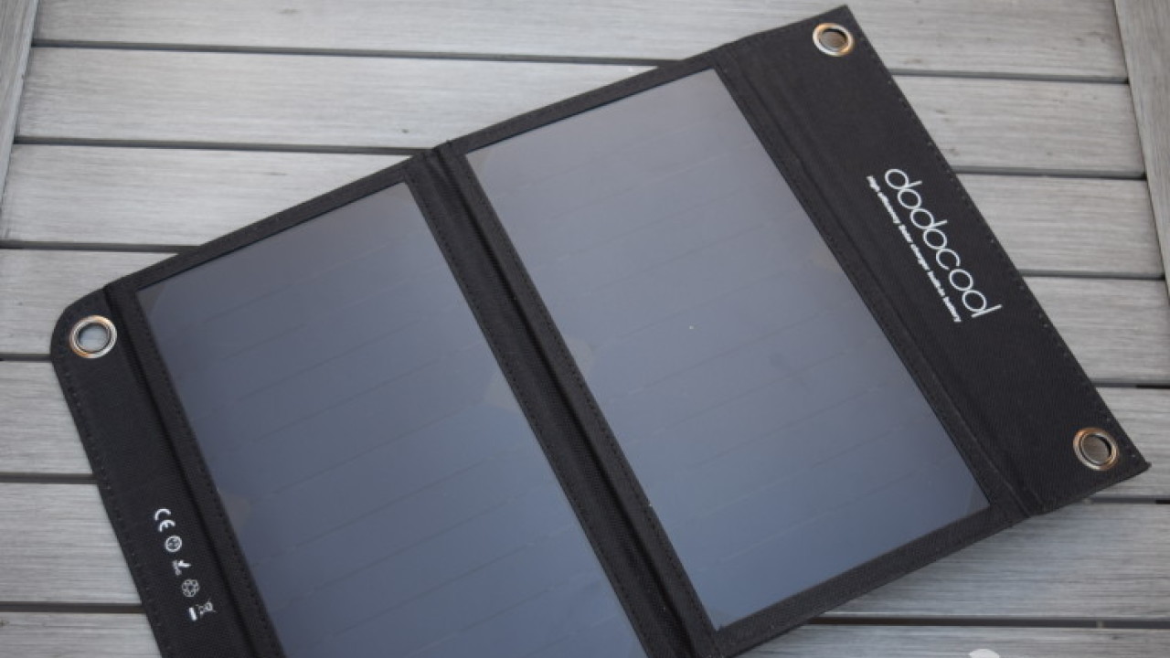

It is completely black in color, save for the white writing, and has two solar panels used for charging the device. It has an extendable stand with a drawstring that you can adjust, to tilt the power bank in the direction of the sun (or simply to get most of it off the floor); and four holes on the corners of the device allow you to strap it to your bag or hang it on a window in order to charge the device while you're on the go.

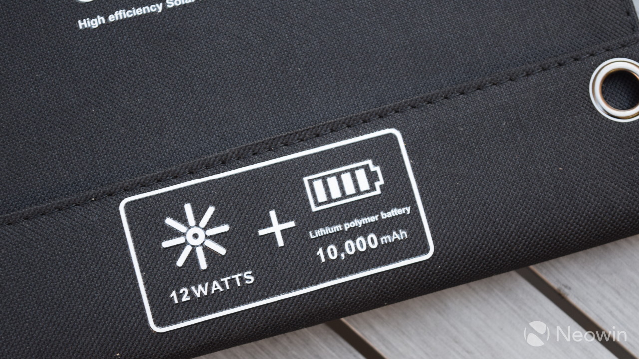

Solar power 12W
Battery type Built-in lithium polymer battery
Battery capacity 10,000mAh / 3.8V
