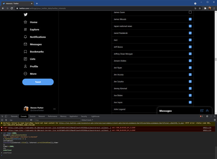

Anyway, there is a way to turn them off thanks to some code uploaded to Github that you can run in the browser dev tools console (which was spotted via Reddit), but it requires a lot of patience, and you will also be forced to uncheck new "Interests", or should I say "Topic Suggestions", that get added to the list every once in a while.
Once you are on that page you will see a long list of checked interests, they will all be enabled unless you have already manually disabled some Interests.
  • On your keyboard hit the F12 key, which will open dev tools in Edge, Chrome and Firefox. You can also right-click anywhere on the page and select "Inspect"
  • Switch to the Console tab in dev tools
  • Where you see a new line with > paste the following code and hit the Enter key to run it.
var timer=1000; document.querySelectorAll( "div > input[type='checkbox']:checked" ).forEach((interest) => { setTimeout( function(){interest.click(); interest.scrollIntoView()},timer ); timer+=2000; });
  • Be aware that after a while the page will say "Twitter is over capacity... " but it will look like it is still unchecking list items, it isn't.
  • Manually stop the script process by reloading the page,
  • Wait a few minutes and then restart the script.
  • You may have to repeat this process four or five times.
On Github, the original code has a timer set of 100, but upon testing and reading the comments I had more success with fewer timeouts by upping it to 1000.
As you can see in our video, I was already quite a ways into running it (by this time I had to restart it for the fourth time) before getting a "Twitter is over capacity..." error. To be clear, the way this page is set up also creates the overcapacity error if you manually uncheck each line without using the script. The page reloads in the background to save the preference, and the further down the page you get the more likely it is that it will fail.
So our suggestion is to let the script run with an ample timer like 1000 or more, and when it starts failing, manually reload the page and wait a few minutes before pasting the script in again and running it in the console.
