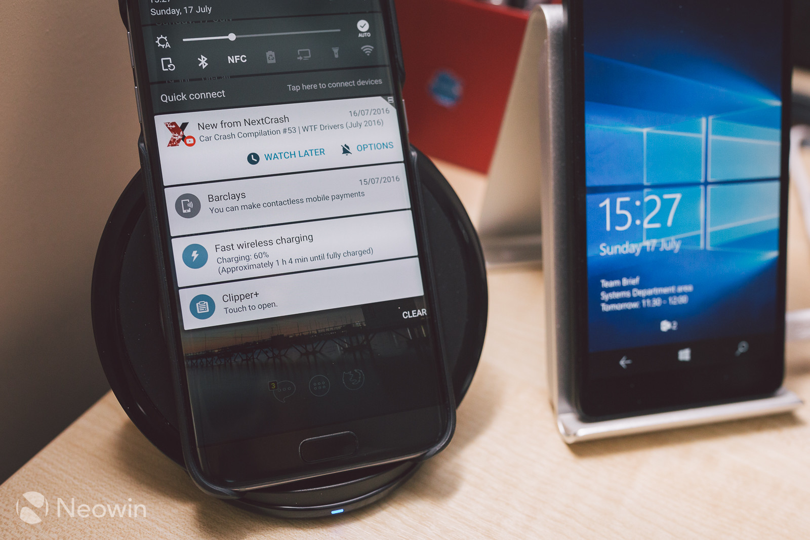

I already have the Samsung fast wireless charging pad and stand, so this comparison would be very easy. Both Samsung chargers take the S7 edge from 5% to 100% in around 2 hours and 40 minutes. An hour longer than fast charging via cable.
The size is the most obvious difference. It has to be noted that both Samsung chargers do have cooling fans built in. Although I am now questioning the need for them, since Tronsmart opted to not use one, and their circuitry keeps the pad to a maximum 40°C.
I guess Samsung are just covering their backs by adding a fan here, and naturally you are paying an extra premium for this, as well as the name.
I found the charging performance to be no different to the Samsung wireless fast chargers. Given the price, the Chocolate then, is an absolute bargain. I wanted to further confirm the charging performance by hooking up a USB voltage and current draw meter.
The Chocolate is pulling 1.29A from the QuickCharge 2.0 USB mains charger. This gives an output power of 11.72W, slightly higher than Tronsmart's rated 10W. By comparison, Samsung's wireless charger drew 9.04V/1.41A, which is 12.74W.
Even though the output according to the meter varied slightly, I found no real world difference in charging speed to really call one better over the other.
Samsung's fast charger, no faster in practice.
It should be noted that both Samsung chargers will only work with Samsung's own adaptive fast charging mains adapter, whereas the Chocolate will work with any QuickCharge 2.0 or 3.0 certified adapter. And funnily enough, it also works with Samsung's adaptive fast charger.
