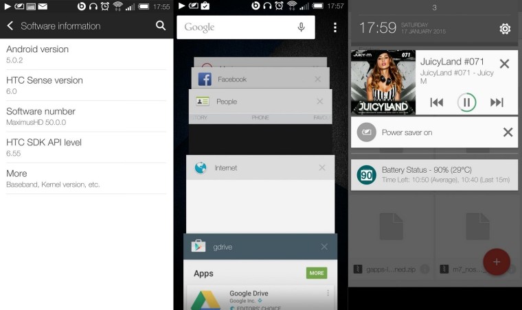

Recognised XDA developer LlabTooFeR has confirmed in a Tweet the availability of his heavily customised MaximusHD ROM (version 50.0.0) for HTC's first gen One series flagship smartphone, the M7. The updated version of the MaximusHD ROM is based on Android 5.0.2 Lollipop, and includes Sense version 6.0 and build number LRX22F.

Android 5.0.2 Lollipop on the HTC One M7.

How to install Android 5.0.2 and Sense 6.0 on HTC One M7 with MaximusHD ROM
  1. Download MaximusHD 50.0.0 custom ROM [Mirror] for your HTC One M7 on your PC
  2. Connect your One M7 to the PC using USB cable. Move the download file to the internal storage of the phone and remember the location
  3. Disconnect the phone from the computer. Enter it into bootloader mode by pressing and holding Power and Volume Down buttons together
  4. In recovery mode first perform a complete clean up, which is obligatory to install the ROM. Click wipe data/factory reset and also perform wipe system/data/cache/dalvik
  5. Once the process is completed, return to the recovery menu. Select install zip from sdcard>> choose zip from sdcard then browse to the location where you have copied the Maximus HD ROM to. Select it and confirm installation
  6. Go through the steps that Aroma installer gives
  7. After the installation process is completed, reboot the phone
Your HTC One M7 should now be updated with the MaximusHD ROM. Head to Settings > About phone to verify the new Android software version.
